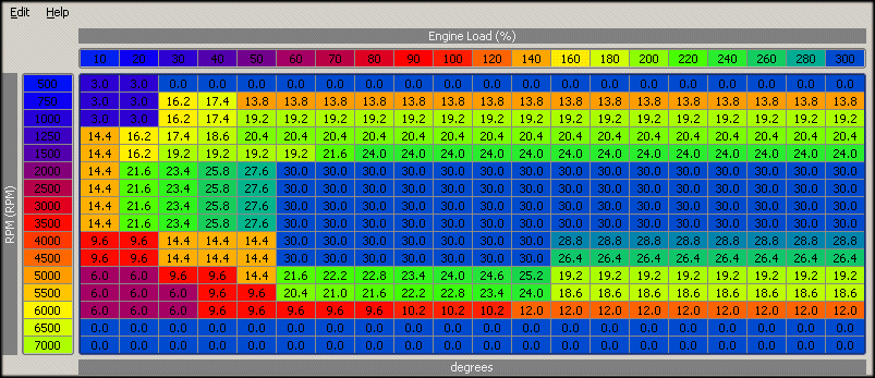

2. Another friend with an Evo IX told me this Mivec map is good and unlocks some power in the car (see below for picture). I plan to load this map onto my car without changing the AFR and timing, will this result in knock? Or is this safe? Also do I load this on all Mivec maps?

You just need to replace this map with "VVT map 1" in ECUflash. If you have the cable to flash your ecu, then you can also Datalog and check for knock using Mitsulogger.

As far as the JDM Mivec map, your should be pretty close to the map you have. I think it is different on lower load cells. Your AFR might change so make sure you log it after with a wideband.

so altering the Mivec map alters the AFR or timiing or both?
