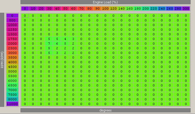

The map that you refer to you I was calling the cruise map...sorry I spose I should have defined the terms. Non Cruise areas would be last load column the car sees, for instance lets say 270ish. Its an odd concept that probably doesnt work, but one of the 99 mistakes I intend to make on the way to 100% coming to terms with this concept.

oh I understand now, editing the low det ign advance table I was referring to by adding timing in the non-cruise areas.

I have noticed this myself, I see more timing than is in that load cell, especialy when logging at part throttle, lighter loads.

Btw, with low det cruise map do you mean this?
