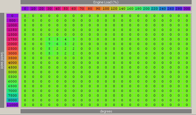

I have this map on my 94170015 '03 model rom, but EcuFlash has it listed as "Boost Enhancement Advance/Retard (anti-lag)" map. There are 2 in total, map 1 has all 0's in the columns, and map 2 has a slight advance section between the 30-80% load columns from 1500-4000 rpm's. As I've been having a "mystery" knock around the 3000 rpm range, maybe I'll play with this table when it's nicer and see what it affects.

I can confirm that adjusting this map DOES have an effect on the cells modified when there is no knock.
Im going to try higher load cells of the low det timing advance map with my 91oct map ,but put 93oct in the tank and see if it will advance with the lack of knock. I will post the results if it works as expected.

Ok I'm lazy you're right I did not look..I did now, but if load log is close to 2byte looks like he is in closed loop timing advance. I've seen timing in mine advace up to 40* at 40% load . There must be a table for limits on this somewhere.
At 40% the EGR is operating diluting the mix, this slows the burn with CO2 and the ecu possibly advances by the "BE" advance table. MAF will see a drop in airflow and so less fuel is used.
When peopl rescale their timing maps affecting the 40% range they often forget to adjust the BE tables which use the sma load axis
Which "BE" table are you referring too?
So it would probably just be a good idea to set all the BE tables to "0" then? Would probably make things easier tuning-wise.
