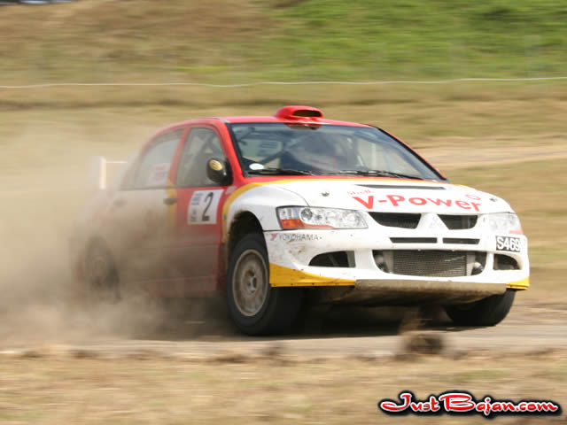

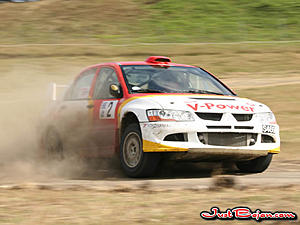

Our best current Group A8 VIII at home keeps eating through turbos at inopportune moments such as when he is in the lead :

Whose car is that? I dont recognize it.

Fair enough . If you had recognized that car I would have said kudos to you. Thats a Barbadian car. Trevor "Electric Micey" Manning. He's been have reliability problems with it for a while but its still been good enough for 2nd overall finishes in Rally Barbados, Rally Jamaica (and maybe the one in Trinidad too?) over the last 4 years or so. Can't remember but oh well. Hopefully this year will be his and he wins at least one of the big three
