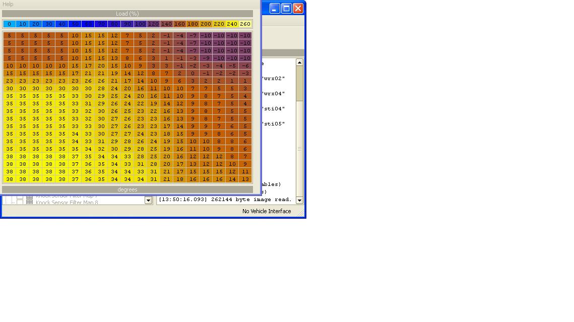

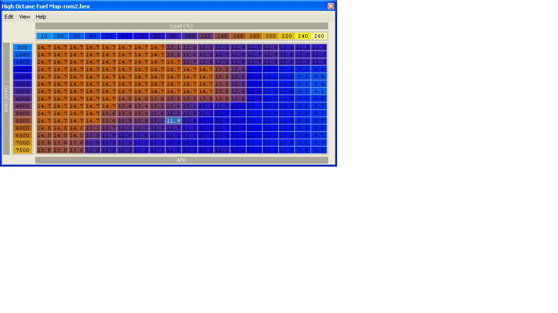

heres my timing and afr maps
Attached Thumbnails post your timing/afr maps:-timing.jpg   post your timing/afr maps:-fuel.jpg

how abt you show rpm in your timing map

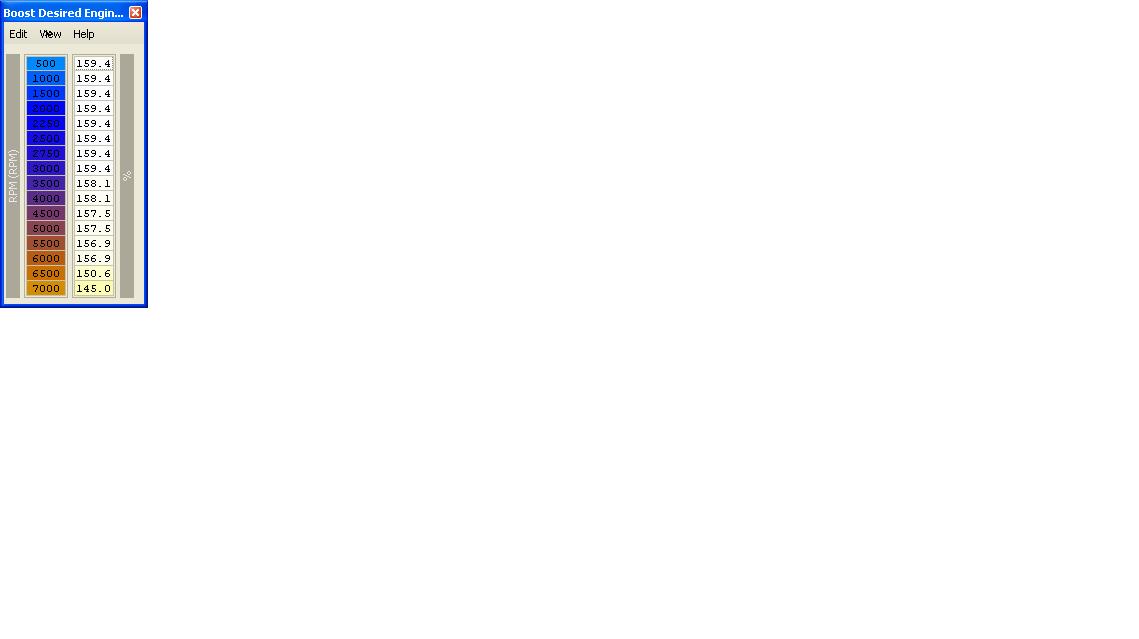

heres the boost map vs. rpm
Attached Thumbnails post your timing/afr maps:-boost.jpg

Looking at your mod list ... that is too low. What loads are you running? You need to base the limits on the actual loads.

well im not running the 2byte mod yet. ^^ what is too low the boost map

TouringBubble's Avatar
Posts: 2,639
From: Chelsea, AL
That is the boost LIMIT map ... meaning you'll hit boost cut if your load goes beyond those values for longer than the delay timer setting. You should be running in the 260s or 270s with that setup depending on boost. 255 limit is good for about 21.5 or 22 psi.
