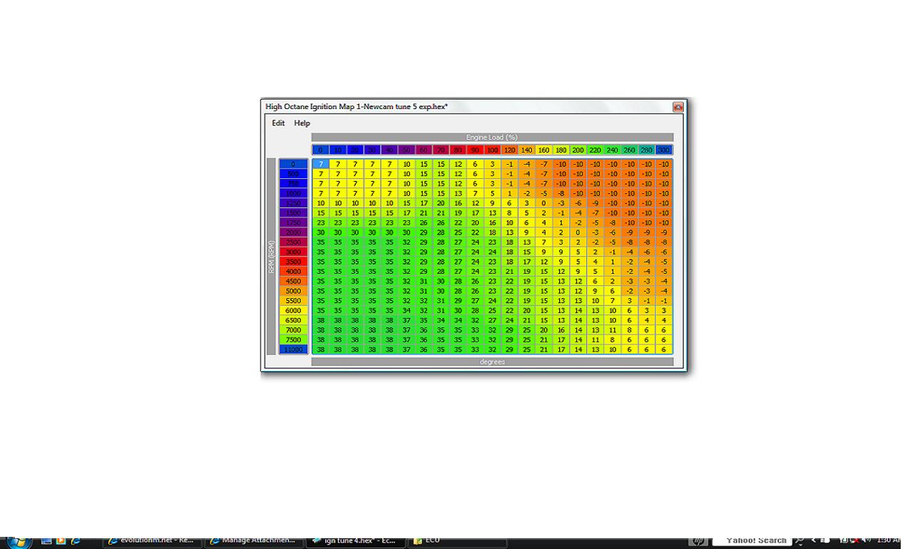

Ok I am having problems on knock with my car Its happening up top around six thousand to redline. Sometimes it happens down low around 3 to 4 thousand. The big problem with this is I dont know why its knocking I cant figure it out. The car is in good service and everthing like that. I am in Utah so I am stuck with 91 octane for that part. But the biggest problem I am having with all of this is my car refuses to drop octane and retard timing it will not go to lower octane maps. I have seen counts of 10 on the car sometimes a little higher but it will not lower octane and it will not even go to lower boost maps that I have. Please any help on this would be great thank you

I have an AEM intake and yeah I tuned it using maf scaling and all fuel trims are at 100 currently. This may be a dumn question but should I post up a copy of my Ignition maps. If so I cant figure out how to copy the image to get it posted. Btw It looks like where the knock is according to evoscan timing advance doesnt match my maps in that area of load and rpms. Would that be the problem??? When I say it doesnt match I mean its higher in some spots by 4 or 5 than what the maps read.
Are you using 2byte load?
If not post a map and a log and i could probably trace it by hand for you

Yes I have two byte load on and this is the map that I currently have i am looking at a map my friend sent me for the last time he tuned me which might be the map i am thinking of reverting to.

Strange that map looks mostly untuned except for the 180 and 200 load columns. Looks like someone copied parts of the 160 load column over which isn't neccessarily a good idea. On top of that it seems like the mid range of the engine high load points are untouched.
Should look more like this
Stolen blatently from the how to tune thread:

Here is the new map that after doing a few pulls and little bit of looking around at some other maps with similair mods that i have came up with so far no big problems with know seen slight knock at top but its better than what it was its a working progress but you were right spike that map was not much different from stock mostly just tuned at 220 240 range. I never hit above 265 load for the most part and thats not till 3500 should I still tune that mid rpm high load area?? If I cant figure it out then yes mellon it is
