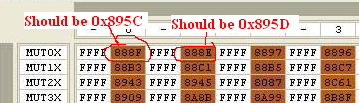

So it should be 895C at that address?
As for MUT00/01, I'm not sure what you're asking. I fished the various discussions for the XML code and 00/01 settings. I have no idea of what works and what doesn't. It's quite convoluted to me at this point.

this should help.

Did anyone notice in his screenshot of his MUT table that his last three 2-byte entries are FFFF? I don't have this stock ROM, but that doesn't look right. I opened another similar ROM and it appears that there should be variables in there.

I am guessing he has overwritten ROM when he tried to do the 2byte stuff...
Ted - when you did the 2byte MOD did you use the big table (as above) or individual cells for MUT00/01?

I used only the individual cells. I didn't touch the MUT table until you gave the values just above (which worked). In fact, I didn't even have the MUT table code in the XML until just before I posted the screen shot.

Thanks for the help Tephra. 2-byte load functions now. I have some ideas as to how all these things can be organized to make life easier for both developers and users.

Ted before you do any more.
Please post the XML for the individual MUT cells.
I think you have overwritten REAL code which explains why the car is acting up...
