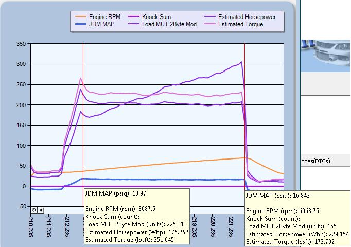

Ive been working on a 87oct tune for a few months here. I have a thread posted on SoCalEvo.net about it. If you want the tune, look for that thread over there.
here is a log on 87 with the tune i posted, no gimmicks. Frwy, night time, after a few WOT logs (this a small sample from the end of a 680kb log)
Im getting (on average) 25mpg, and still making a bunch of power on 87... all thanks to the wonderful support I get on this most beneficial forum
Note: at this point i was watching my EGT's, and they do start to creep over 1300°F after long WOT pulls in 5th gear. This indicates to me that the limits of timing and boost are getting very close on this octane.

1300F egt's? That's cold.
1650F is where you don't want to pull much past.

^heh... thats steel cutting temps ...
they werent too bad. I looked down and saw 1400 and climbing and decided to let off.
this was on stock exhaust, Tanabe DP and a K&N... (ive sold off all my parts to pay for school )
p.s. no way i would ever suggest using this tune for racing/togei'ing/dragging ...but it sure works for those Frwy stoplight drags ...lol.

One main reason i made this map was to see the limits of timing across all areas. I developed the timing and fuel maps by targeting all the load areas, i.e. just 100 load then tune for just 150 load and then tune 200load.
Id almost say that you could run this tune with 91oct, and go out and race on it for a few laps (not good enough to combat heatsoak, tho).

Redline how close is your 87 octane map to the stock "low octane" map for your evo 8? I have and evo 9 and am trying to draw a conclusion.

Good job! But I gotta agree with Honki24, I'm not going back to low boost. I got a second car for that kind of power (or lack thereof) and regular unleaded
Nevertheless, you should post up your timing maps and a log that would show your AFR's.
