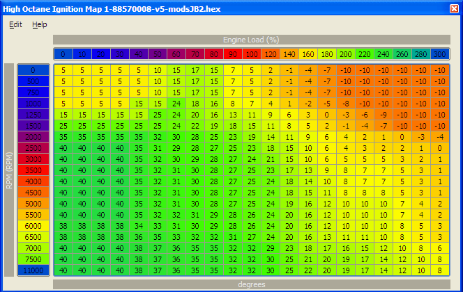

All seems to be part throttle or lift off.
I attach my timing map for 9 FQ340 on 99 RON with Walbro, 3" exhaust, airbox mod running similar boost (except I hold 25 PSI to 6000 RPM). Tested over a year in all driving conditions - see how savage I had to be with intermediate load timing. I've used just enough retard to get rid of all predictable, repeatable knock. Occasionally I get a knock count a little higher, dropping off an octane number of 100 happens briefly about once very few months (I log continually on Pocket PC), but the conditions are not repeatable, or the odd lift off count of 7 or 8 very occasionally, but again not predictably.
The sudden ramp up in timing with weird mixtures on lift off (from the remainder of what's in the inlet manifold and whatever fuel the injectors add to it) probably creates an odd combustion event during the actual lift off. It does seem to be timing responsive. It may well not do any harm at all, but I got rid of it because I could.

i will work with my timing to see if that helps.Im definately suspecting my aps BOV for lift off knocks.
i will try your timing jbs, mine acctually looks all over the place.

i think you right there,i adjusted my timing abit,so lift off knock is gone,but still getting few knocks on wot after 5rpm
