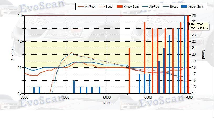

So I have been tuning the knock sensor on my car and just gonna post what i have so far to see anyone wants to make some comments. I've been tuning the knock sensor in combination to reading the spark plugs and even recording audio feed back off the knock sensor (Det-Can's).
Here's what I'm getting on the logs atm...
The Blue log is with Knock Multiplier settings of 19 / 19 / 31.
The Red log is with Knock Multiplier settings of 20 / 20 / 31.
I'm trying to keep the multiplier settings as low as possible but I'm gonna have to keep raising the high RPM setting till I can get some better results. I originally was getting 24-32 knock counts up top and with the setting at 31 I'm now seeing 17-19. By the time I tune it all out I doubt there will be much left to listen for any true knock but we will see.

Conclusion so far... The spark plugs look perfect, the car even when its pulling timing for knock is running great and pulling strong, the audio is very noisy but I don't hear anything I would think would be knock but its hard to tell. I do think that up top the noise level picks up a great deal and its understandable that the knock sum is failing so hard, I'm just not sure why. When i test the factory positioned knock sensor maybe it'll sound a little clearer. I question if maybe the valve-train is responsible for the noise in the higher RPM but not exactly sure how to test it or why.
Well that's what I have so far... notes, comments, suggestions, or questions welcomed.
