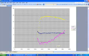

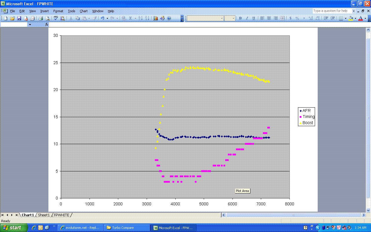

Originally Posted by roger smith
Jeff, maybe you haven't seen you've wanted to because it's rare for someone to just change their o2 housing (turbo outlet pipe). I got one and was planning to install it the same time as my turbo as it seems the outlet pipe is a lot of work.
I think changing out the outlet pipe is the same as going from stock cat to high-flow or straight pipe. Have you seen someone that went from stock cat to straight pipe run exact same boost before and after?
Chamama, I think the Tomei exhaust manifold was supposed to increase spool time, or maybe that was just for silvias. Did you change your boost control around spool up or leave it the same as before the manifold?
I did not change any boost settings. Maybe because I installed the manifold and O2 together, I didnt see much loss in spool due to manifold only. Here is a graph of FP WHITE installed log.
Attached Thumbnails Comparison graph of boost before and after O2 and Manifold install (91 octane)-fp-white.gif
Old Jul 15, 2008 | 01:00 PM
  #68
roger smith's Avatar
Posts: 357
From: Ventura County, CA
Oh sorry. I meant spool time should go down. You should get full boost onset sooner.
If you didn't change any boost settings maybe you should try. Could start spooling sooner than you are.
