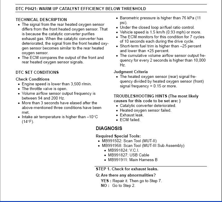

Short answer is it won't work. mrfred and I had a discussion about the rear o2 sensor readings in the 'eliminate your rear O2 sensor' thread and when he wrote his patch for the rear O2 sim and I applied it to the 05 ROM.
To use mrfred's words, the ECU is basically looking for an attenuated signal from the rear O2 sensor as compared to the front. The FSM states the following:
It states that the ratio of the frequency from the rear/front has to be .15 or greater. Since the cat is attenuating or smoothing the signal, the rear O2 will never dip too low to drop that ratio below .15, or at least that's my understanding. If you remove the cat, the rear O2 now cycles in a much wider range, similar to the front, and since it will be slightly lagged behind, it now can be at it's low point in the swing while the front reading may be at the high point and the ratio may be below that .15 criteria.
There are also many other conditions it has to satisfy that mrfred talked about, but to answer your question, I don't think using the LC-1 as the front O2 input will eliminate the cat efficiency cel.

So, for the math ... if O2 2 / O2 1 = more than 0.15 (averaged over 10 sec.) the CEL trips?
So, O2 2 would have to average .07v if O2 1 averaged .5v ... I need to log both and do a comparison. I see why it wouldn't work though.
