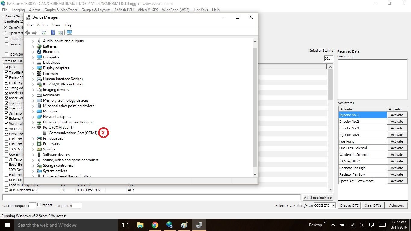

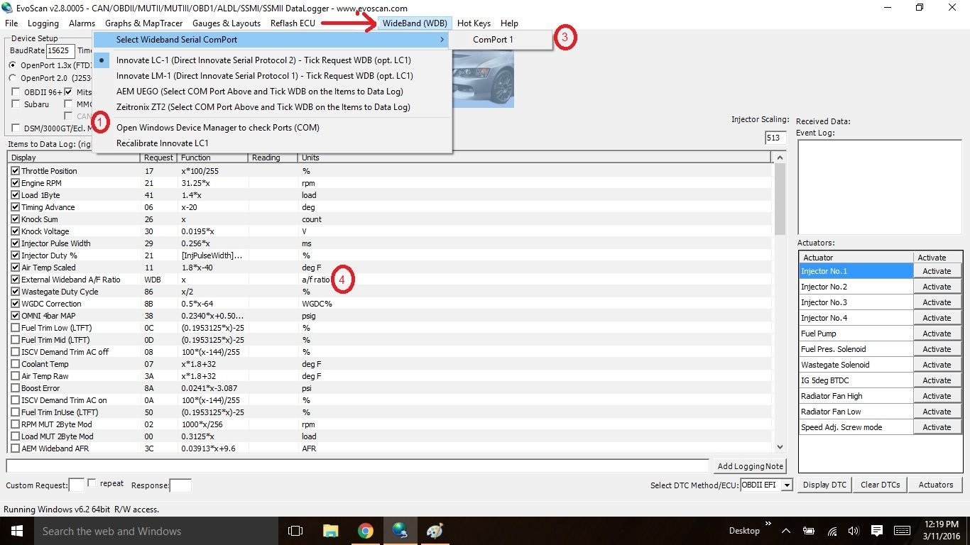

Once everything is hooked up and the USB cable is plugged in and drivers installed, you can start EvoScan. Now you have to adjust your settings to log AFRs from the LC-1.
1. You will need to click on "wideband WBD" as noted with the red arrow.
2. From the drop box, go down and click on the selection notated by the red "1".
3. This will open your Device Manager where you will expand the "ports (COM & LPT)" section and see which COM port your wideband is connected to, indicated by the red "2". It should say something along the lines of "serial to usb adapter", etc. mine says "Communications Port" because i wasn't connected to my car when i did the screen shot. In my case, my cable is connected to COM1, yours may be a different ComPort. Either way, just remember which port you are using.
4. Exit the Device Manager and go back to EvoScan.
5. Click on "Select Wideband Serial ComPort" (as indicated by the blued area in my picture), then select the ComPort you saw in Device Manager. (the red "3")
6. Select your wideband device (indicated with the black dot in the blue square).
**note: I'm not sure if it matters if you do step 5 or 6 first.
Now, you are wired up and EvoScan knows where the signal should be coming from. You can run a test log to confirm. If it's working right, you will see values in the "External Wideband A/F Ratio" portion of EvoScan while logging (the red "4"). Of course, you will need the WB sensor and everything else connected in order to test.
Once you are set up, it's all good and you shouldn't have to mess with it again.
As for the rest of the logging duties, that is all handled by your Tactrix cable. It will log everything else.
Hopefully I'm not forgetting anything. Oh, and i THINK you will need to use the same USB plug for the wideband, each time you log. If you plug it into a different one, i believe that changes the COM port so you will either need to swap usb ports or change the COM port in EvoScan.

Thanks for the pictures bud, can't wait to get my cable to play around with all the stuff.
