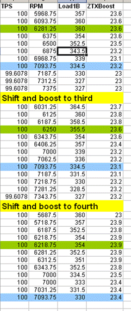

I did a lot of cutting and pasting to make this fit, so don't get hung up by the deleted cells. Here is a sample of a log I did just 4 days ago. Even in the mid 300s of load, I'm seeing very little variance in load between 2nd, 3rd, and 4th gears. More than Razorlad, but still pretty close.
