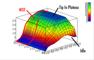

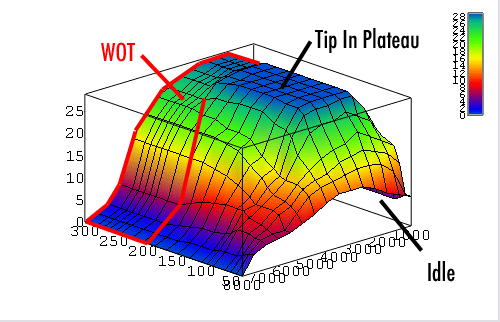

With MIVEC, you'll need to know the increments ... it jumps by like .8 or .6 or something. Min is -1.2º and max is 28.8º. You probably want to lock the idle area (0-40 load and 0 - 1000 RPM) and maybe the dialed in curve at WOT (200 - 300 load). Just let the cruise and tip in areas be smoothed.
I don't have my custom map available to send right now, but let me know if it will help and I'll send a ROM to you. Please note that my MIVEC settings might not be common though ... not sure if it matters for your needs.
EDIT :: Attached my smoothed graph with notes.

About what I figured. I might set those areas to default not smooth. The nice thing about the way I have the sheet set up, if I may be so self satisfying, is that you can set those areas to not smooth, then go through a few iterations, and then turn off the smooth limiting and smooth it one more time to just touch up those areas, even using different smoothing limits to prevent more or less advance.
and yes your map does not appear common as there are a few features of the oem map I used that yours is missing. But that isn't a big deal in this case anyway.
Thanks for the help.
