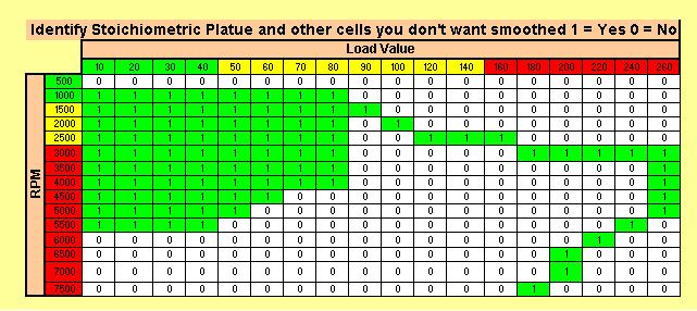

Slow weekend...so I was fueling around (pun hahaha) with the Autosmoothing...again.
I decided to map trace over the smoothed fuel map to see how the WOT cells were affected by the smoothing. I observed that some of the highest percentage of change via the smoothing was occurring in the WOT map trace. Ummmmmm...
I suppose this is understandable, however I began to question if I really wanted the max change to actually occur in the map trace cells. Maybe not. So, I used the DO NOT SMOOTH table to lock out not only the Stoich cells, but also the traced cells. See attached.
It would seem that I am now smoothing the fuel map 'around' or 'to' the map trace zone.
My question: does this make any sense? Or, am I simply defeating the whole purpose of the smoothing process?
In my opnion the whole point to locking known values (Values you logged) is to smooth TO those values instead of smoothing those values. That's how i would use the tool.

Jumperalex's Avatar
Joined: Sep 2004
Posts: 413
From: Alexandria VA
Consider though that what you are then doing is basically smoothing out cells you have already identified you are not using. That isn't to say that the basis for what you're thinking is wrong ... certainly you'd want to give more weight to the cells that you ARE using since presumably those are the very same cells you have spent th emost time tweaking.
But at some point you DO want to ensure that the transitions you make from cell to cell is smooth. So if anything identifying the cells via a maptrace has now shown you the cells most important to be smoothed ALONG THE TRACE.
Of course there could be ways to do that automatically (smooth first on cells you ID as critical but still requiring smoothing) but sadly, as anyone watching this thread has seen, I have been woefully inactive with no time to dedicate to it really. I haven't even hooked up to my car in over 6 weeks.
The nice thing is that with those cells now identified it really shouldn't be to hard to manually smooth just them relative to each other, and then lock them and smooth the rest of the map.
So if smoothing is your bag, then you don't want to ignore those map traced cells, but you might want to hand smooth them first.

Jim in Tucson's Avatar
Joined: Oct 2006
Posts: 1,480
From: Tucson, Arizona, USA
Good point, Jump. I actually wanted to smooth the 'tunned' or 'traced' cells first, then smooth the rest of the map. I just could not figure out exactly how to do that since the map trace is more linear. I'll try smoothing the trace, then the rest of the cells. I'm just not sure your algorithm will smooth as well on a linear data set.
