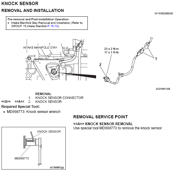

So it has to be precisely torqued ey? I need to figure out my problem...
So are you saying you made it finger tight and fixed the issue? I don't understand exactly.
Spec is 17ft-lb +/- 1ft-lb

That socket looks a lot like the generic sensor socket you can get at Autozone. It has the slit on the side but its stepped with two different socket sizes on the inside. It'd be feasible to get the smaller in.lb. torque wrench back there and torque it to 204 in.lbs.

Okay, I PMed Darwinn to clarify:
Quote:
Originally Posted by honki24
I'm trying to figure out exactly what the issue was with the knock sensor in the car you guys "fixed". Was it loose? Was it too tight? How did you fix it? Did you just make it finger-tight or did you torque it back down to 17 ft-lb?
"Knock sensor loosen from the block, maybe it come free from vibration or something, I dont know exactly.
Its very hard to get to knock sensor, by I personally done this with my hand - tried to turn it, and it was LOOSE(free) but insinde hole. ( Not torqued at all ).
This given phantom knock everywhere, but more upto 4000rpm. At WOT runs 95% of time we had 0 knocks.
We choose to use "Lactite". So got it out from the block, used some lactite on thread and torqued it back with stock specs.
No any problem for now. No any false knock."
