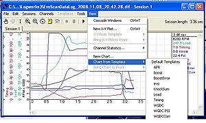

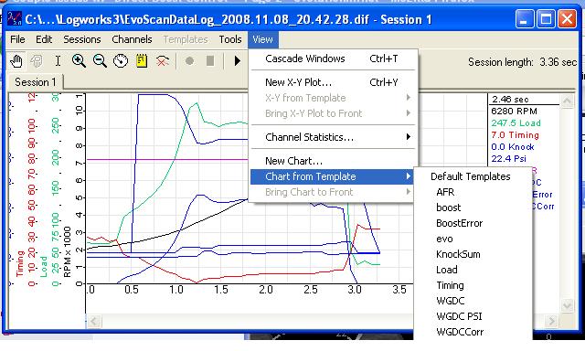

rename this file from txt to dif. copy lwtemplateUse excel to copy/past the necessary fields from you logs into the dif file and then open it with log works.
Step 1
Open the log file (Cntl + O)
Step 2
View | Chat from template
I found where my chart templates are saved. I can email you the file. pm me your email address.
Attached Thumbnails Couple issues w/ "Direct Boost Control"-lw3.jpg

Extract this file into your LogWorks3\LWSettings directory. I hope you're installed version 3.0 This file has my charts but change the rpm to match your boost table rpm.

emailed you the files....
