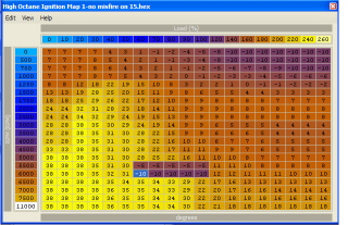

Someone advise on this map
So I bought an openport 2.0 and cant log yet so I though I would try to look at the flash that was previously installed to see why the car doesnt feel fast to me. Anyone ever see some stuff like this? 5500-6000

boost building on 2step

I should have never posted that trick, should I?
Yeah, that's to build boost on the 2-step. However, with that much timing pulled, it's likely only there to shoot flames on the 2-step.

Yep it does shoot flames on the 2step. I have been looking at others maps and just didnt see that much timing pulled. Thanks guys. Map look ok otherwise.

I think you'll find quite a bit of timing to be had in the mid load regions <220. I'm sure itll be a bit more responsive. You should definately log though before any timing changes. Timing you can run without knock can vary depending on your mods. I'd advance the timing in the 5500 to 6000 rpm low load region too. The EGT's I bet are pretty high with this amount of timing. I also think the current timing dip is in the very low region of load for 2-step. I've logged ~160-180 for 2-step. Maybe they were looking for flame shooting on upshifts at these rpms?
Good luck and have fun with it!

Nah, if they wanted to shoot flames on the upshift they would pull timing in the lowest columns (<40%), unless they're using NLTS. Even then it would need to be in more than just two rows to be consistent.
