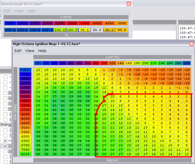

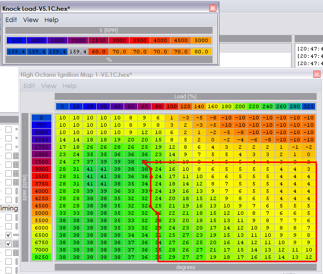

If I understand this correctly by making the following changes I should be effectively changing the realm of knock control, correct?
for the 94170014 and 94170015, just copy and paste in the following:
Code:
<table name="Knock Load" category="Timing" address="421a" type="2D" level="2" scaling="Load8"> <table name="X" address="635a" type="X Axis" elements="10" scaling="RPM"/> </table>
Tephra, I really still need your code, this only helps with phantom knock, but doesn't help with the "sensitivity" of the sensor.
Now question... why would it stop at 159.4?
---BEFORE---
---AFTER---
honki24, you got it.
On ECUs I've seen other than 9 JDM GSR it looks like below that area knock control will just be less sensitive (needs confirmation, and the sensitivity and maximum is adjustable if it is a problem). Also your red outline should officially go to 159 at 2000 RPM and below as engines with MIVEC and stock turbos, or strokers on small turbos may be able to exceed.
The use of 159.4 load scaling is interesting. If it is an issue, we could change the load used, but 159.4 on a standard car is about actuator pressure in typical temperatures on a stock turbo, we probably want a good reason to have knock control disabled there unless people are getting false knock that high up.
