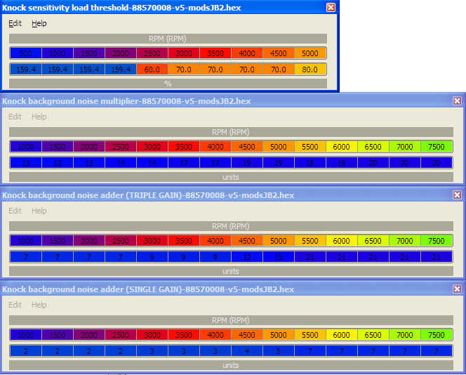

well ive been using this table for the past couple days and it has really let me drive the car again, i have the load threshold at 3500rpms up around 130 load. this greatly improves around town drivability. however when doing a full wot pull from 2k rpms i will pass 3500 rpms at about 250-280 load, this causes the ecu to pick up some knock although now the counts seem to be less than they were before.
ill post up some logs with my findings later

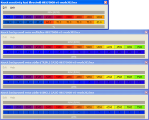

Here are the four knock control 2d maps, hopefully all we need...
Nice one, glad it works for you. I have no false knock to test, I just like logic puzzles
I have finished disassembling the knock routines They are sophisticated with adaptation and filtering techniques to develop a background noise level. In addition to the first table I posted as the subject of this thread, there are three other tables which we will be able to adjust. They are all RPM based. One is a multiplier and two are adders that udpate the background noise level as the engine speed changes. The two adding tables are doing the same thing just at different amplifier gain levels for the knock sensor. You will note that rounded off, the triple gain table entries are simply 3x the single gain table entries. Since the ECU can switch between amplifier gain levels mid pull, they should be kept scaled together like this. These three new tables you would expect to have to update on a noisy engine that suddenly increases in noise at say 3500 RPM... if you didn't the background noise estimation doesn't keep up, the ECU decides it is knock and then the background noise estimation is further stopped in its development. So once you reach a noise tipping point it all goes wrong! We should be able to log a knock free noise curve like say AEM to guide setting of these tables with a few calculations.
I will put together a description of the full knock control system soon (there are multiple levels of filtering and lots of switches and conditions, but I have disassembled them all now). Perhaps later we can put together a concise version once people have tested practically.
