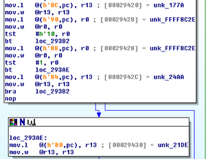

96420008:
Multipliers:
177a 13
24aa 18
21de 20
For those trying to disassemble, if you find the first value at 137a or 177a, the routine that references this address has the other two addresses called nearby. It is ultimately called from the longsub_inj 802Hz called from CMT0 interrupt (vector 2F0 in all SH2).
