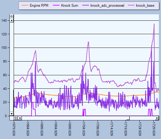

I've had a nasty 3500rpm knock since installing the headers and it's not gone away after changing to a built shorty and head and different cams etc...
I was going to do a bunch of experimenting and thought what the hey, I'll use the settings you guy came up with and just see if it's worth doing or not. I'm impressed, check out the before and after...these are from two long logging sessions and I set excel to display every knock count above 0

Eventually I'll get around to fine tuning it to my cars like but for now that quick and dirty change sure did make the difference. Previously I was having to disable the knock sensor altogether just to be able to dial in the fuel/timing since the ECU was so heavily involved in trying to help due to the crazy false knock.
p.s. don't get to hung up on the afr/timing I'm running, I just changed turbos and haven't dialed it in yet.
