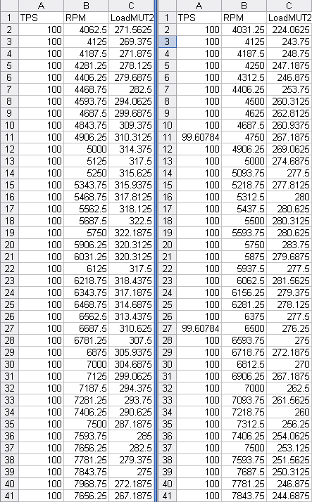

Not sure why it decreased, and yes it doesn't make sense. I epoxied all the edges that touched the MAF screen (purple, yellow, red, and lines in picture).
Here's a screen shot of the "before" and "after" MAF epoxy.
Left side = before epoxy, 91 octane
Right side = after epoxy, 91 octane (getting ready for 50/50 meth in the same dyno session)
No changes to boost, timing, or mods

wow Kev, that's no little drop either. I really think something else is going on...injector scale change perhaps without accounting for it in the evoscan calculation maybe? then again that's probably 2byteload...hrmmm. If the airflow truly decreased that much the power would have dropped accordingly. I assume it was dyno'd after the change to get the power back where it was.
Yeah, it's weird. lol Yes, it's 2 byte load. 2 byte airflow wasn't logged on the 91 tunes.
Power actually increased from 409/315 to 415/317 on those logs you see.
