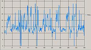

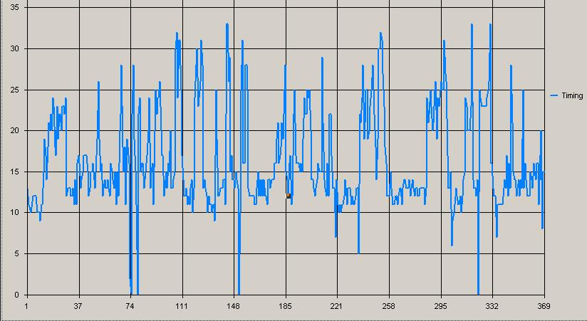

I noticed this strange dip in my timing for on obvious reason !
Low load, low rpm, no knock, decelerating everything seems normal ! Then there's a sudden drop to 12 to -15 !
It's low load, low rpm, both my maps (high and low octane) points to +ve figures, around 16 and 12 respectively.
Just wondering, what triggers this dip for no obvious reason ?

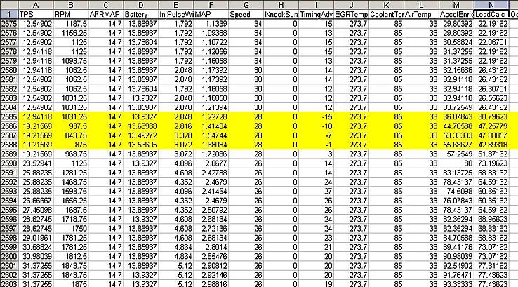

TPS attached here. Note that 12.x% is my 0% throttle.

Originally Posted by tephra
got tps logged?
Thats exactly what I was thinking, but his TPS doesn't show an abrupt let off of the pedal. His RPM has a subtle drop, but nothing else stands out as a cause for the sudden change. His TPS actually goes up, along with the IPW and Accel Enrichment.
Hmm, load takes a small jump up too.

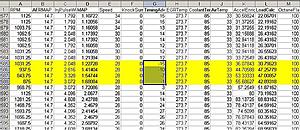

I've another log that shows many such behaviors:
- Line 649 to 653
- Line 785 to 788
- Line 1068
Something must have triggered it......

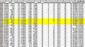

And ... I just pulled my COMPLETELY STOCK Datalog ..... it happened too !

the reason I ask, your tps went up, your load went up, but your rpms went down, which would indicate lugging the motor. If you were getting false knock, lots of it (but you say there was none indicated) your timing would drop.
