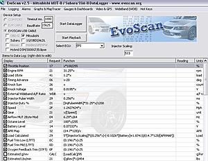

Is there something specific that I need to be logging for the map tracer to work? I went back to my old laptop (the one where map tracer worked fine) and loaded my most recent logs (the ones from the new laptop) and same thing, nothing comes up when I check an item. So I took a log from my old laptop and tried it on my new laptop's evoscan and it worked. This leads me to believe that I'm not logging something that I should be.

Wouldn't that be easy enough to check? Look and see what items are checked. It could also be when you load your .xml and map that are required for maptracer to work properly.

+1. Just turn on both and compare whats being logged....

Well to be totally honest I dont know which item(s) I didn't select that caused it not to work so I just duplicated the selection from my previous laptop and it worked. If I remember correctly I was only logging rpm, tps, 1byte load, timing, knock sum, knock volt, and wideband. Apparently it needed one or more items to be selected.

I'll bet its the loadcalc that had to be selected.
