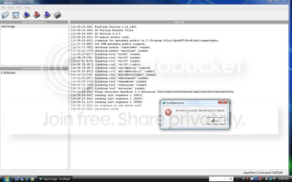

When i try to read my ecu this is what i get:

failpic?
I think you have an extra http in there...

battery voltage is to low - drive the car around the block or idle for a while and then re-try.......
most likely the issue.
