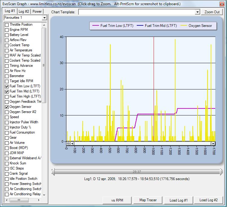

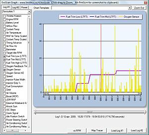

I made another log with my first map
I will upload this file with all the o2 sensor enabled plus the coolant temperature and scalling.
I don`t know from where to get a def file with min temp for closed loop either......
I will search more......
Attached Thumbnails P0125 Trouble Code-o2-second-map.jpg   P0125 Trouble Code-02-fuel-trim.jpg

hate those graphs
daniel can you e-mail me a log csv file . tick over warm engine
just tick the fuel trims /o2 feedback/ fr and rear o2 /eng coolant temp
