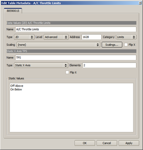

I tried 1628 on my 88590015 rom and EcuFlash did not seem to like that location...
Anything I am missing here?

You are missing the scaling from post #20. You either did not add it as listed above, or you changed it.
