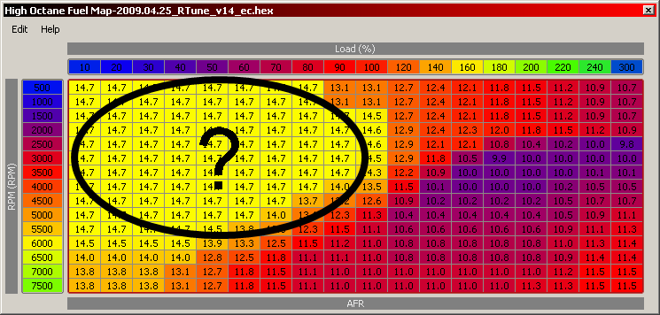

After installing new injectors and getting all the fuel trims dialed in, I also updated the fuel maps to get to my desired AFRs. A large portion of the fuel map is a block of 14.7, does that value have to change with the new injectors as well?

No. Don't you have a wideband? You can confirm that.

your map looks funny to me, the 14.7 is probably fine, do you have a wideband? Are you running meth or E85? Why does your map at WOT start out rich and lean out alot?

I'm using the OEM O2 to tune the AFR (no wideband), it works pretty well if you have a good starting map that was fairly close (tuned by somebody who does have a wideband). I guess I don't really understand why the 14.7 area is different from the rest of the map - is that where the ECU runs "closed loop" vs. "open loop"?
My boost peaks 26psi around 3500 rpm and then drops off to 22psi up top, so I run richer in the peak boost area to prevent knock. From what I've learned so far, "heat = power" and "too much heat = knock". Heat comes from compression (boost) or lean burn (EGT/AFR). Since the boost drops towards redline, I can get away with adding more heat by running leaner.

the 14.7 is closed loop area, unless you defeat that function. if you run open loop only you can use that area
ok that makes sense. Do you know what values (rpm, load) the transition happens at? I rescaled my map to get finer control at peak boost and higher max load and I'm wondering where exactly the ECU switches over ...
