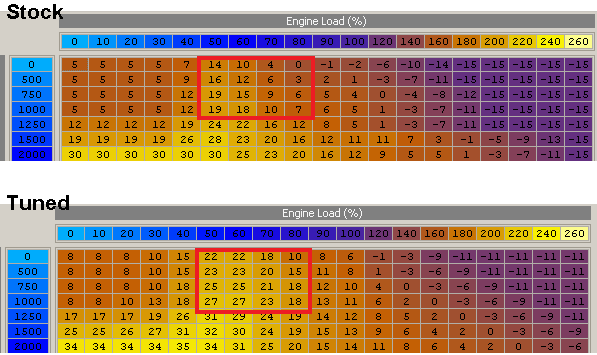

Lots of timing advance for low end - Comments ?
In an attempt to strive for perkier pickup, I advanced my low end 50-80, < 1000rpm by quite a fair bit.
There's no knocks, and indeed it felt good. My only concern is, am I advancing way too much to cause any harm ?
Comments ?

are you even hitting that cell?

Errm ..... when it's idling and when I'm just moving off ?

I was gonna ask the same thing as tephra, have you logged and verified you hit those cells?
I know every car is different, but from what I remember the only time a car hits those is possibly when your going uphill...? correct me if im wrong tho
~1000 RPM is super close to idle, i'd think load/rpm would increase a lot faster and hit entirely different cells than those from a standstill --> first gear.

if you want a lil "peppier" take off, in 1st, from a stop, set up your MIVEC map from 10 - 40 load and 500 - 1000 rpm like this. see how that feels...
load 10 20 30 40
500 3 3 3.6 4.2
750 3 3 14.4 14.4
1000 3 3 16.2 17.4

It might not show any knock either because it is way below the threshold, but this is the sort of areas of the map where knock is common to occur.

I've no MIVEC. But yeah, you're right ... they're literally skipped over during acceleration, touching them with a few hits before going into higher rpm.

That, however, is a good approach. Try it in your spoolup cells till you get a bit of consistant knock and back off a bit. What also helps is making sure that most of your spool area is ~12.5:1 and only gets rich by peak torque.
