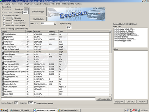

Originally Posted by acamus
Can you PM the log? or at least what was the CA reply?
Here is a screen shot so you can see the reply... The log is too big and I can't break it up to zip it either... basically I let it idle for 10 minutes then entered the CA request, then let it idle for another 15 minutes and no change in the fuel trims...
Ok I will give it another shot, the command was not executed at all when looking at the reply.
Also after looking in the logs under request after I entered CA the request cells read 255... i don't know if that helps...
