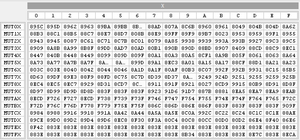

So I loaded those defs into evoscan (running 9417 V7) and logged them.
The ac off trim moved from -8 to -10
The ac on trim was static at -56
So, if I read this correctly, I need to pull 8-10 ISCV steps from one of the ISCV tables, question is, which ones???
Logs attached, ac off, ac on, both with some free rev MAF induced low RPM stumbling at the end of each log, just to remind me it's still present.
I believe what you logged was percent though, so you don't need to pull steps, you need to pull percent if I'm not mistaken. How the heck was the ac on trim -56, if the min max ought to be +/-16?
The factory starting value in my ROM is -1.2%, so assuming its the same for a 9417, then -8% to -10% suggests that the ECU pulling lowering demand from the factory starting value. The -56% indicates to me that MUT 0A has been modified because the ISCV demand trim algorithm bounds the value to be -16% to +16%.
