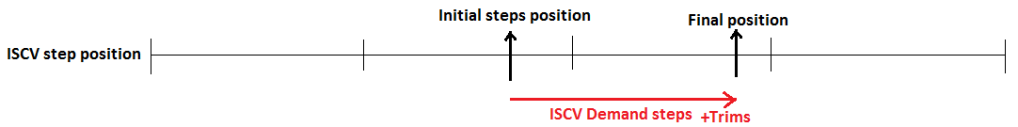

I found that it's best to leave the stepper table linear on the lower demand%.....
so for a demand% value, all the steps will be the same. Idle fluctuation vs coolant temp will be corrected by changing initial steps.
Let's say you're at 27% demand on a startup. Coolant temp is 45 fahrenheit.
So my current stepper lookup table:
So you can conclude that stepper value is Initial steps + 62
Let's say it's idling to 1000RPM
Here is the target idle table:
As you're warming up let's say you reach 68F: You're still at 62 steps, the idle is still 1000RPM. If the stepper table wouldn't have been set for the same steps for a same demand%, Idle would have fluctuated from steps changing without any demand% change, than happened to me while testing.
Let's get back to the warmup sequence. You reach 81F, steps are still at 62 steps + initial steps, but the idle has raised to 1100RPM. If you want to keep the idle on speed, you have to readjust steps without affecting the demand%.
How? by changing the initial steps, you're shifting the opening of the ISCV without affecting actual demand%. It will keep the trims from readjusting the demand%, thus preventing idle speed variation.
So you raise the initial steps at 81F (68 and 93). Next time you'll cross this area warming up, the idle will be closer than what it was, and the demand% won't need to change to keep idle speed. Keep adjusting that until it's very stable for all coolant temps.

Trust me, the logged steps are a combination of initial steps+demand%+demand trim.

You really need to be logging your MUT08 DEMAND TRIM before you keep on about this. MUT16 is the active ISC Steps with ALL corrections included. Initial steps+demand%+demand TRIM. Have you started logging MUT08 yet?? You can't argue something without all of the data we are conversing about.
It's stuck at 6.275% for all the warmup sequence until it start to work between 5 and 6% at 175F.
What I think is that the logged demand% (76), is the final demand%. Trims are already added to that number.
What you say wouldn't make sense because at example 45F, initial steps are 89. So you say you'd log 89initial+67lookup+trims? It would have been a too high number and I never logged 100+steps in any situation.

Add 4-5 steps to your initial steps table and you'll see the DEMAND TRIM value come down.
Yes that's what I'm doing to correct the demand trims.
