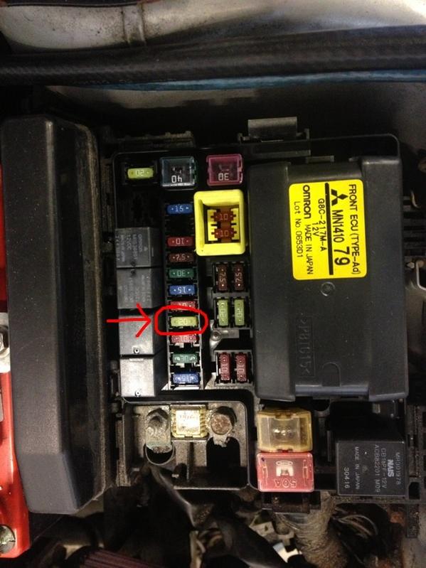

Reset only works on the evo 8's. Just shut the car off and pull this fuse for 5 seconds and reinstall. It resets all fuel and idle trims on the evo 8's.
-Jamie.
-Jamie.
This^^........
for our friends with IX it'll useful to find what's up with these values staying stored into ECU ROM memory.
