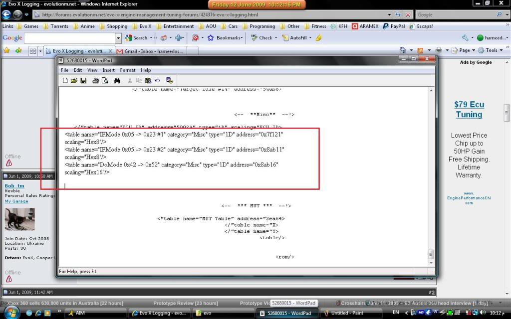

ok fellas .. after reading this thread for 3 days non stop and i finaly got it, but just to be sure here is what i'm gonna do:
i got my ROMID
copied the 3 xml lines and pasted them as shown to my ROMID file on ECUflash
now i open my "tuned" map on ECUflash and edit the numbers as shown
reflash the map again to my evo and i'm good to go ??
please note that my romid is 52680015
there is another file named 52680015_mod in the rommetadata file

<table name="IFMode 0x05 -> 0x23 #1" category="Misc" type="1D" address="0x7f121" scaling="Hex8"/>
<table name="IFMode 0x05 -> 0x23 #2" category="Misc" type="1D" address="0x8ab11" scaling="Hex8"/>
<table name="DoMode 0x42 -> 0x52" category="Misc" type="1D" address="0x8ab16" scaling="Hex16"/>
I just need a clarification.
1. I simply copy the dat in the quote above and drop it in the 52680015 xml file. Correct? I do not have to put this data in the 52680017, 52680018 and 52680020. I openned these files and found no data in them. They simply point to the 52680015 data.
TIA
