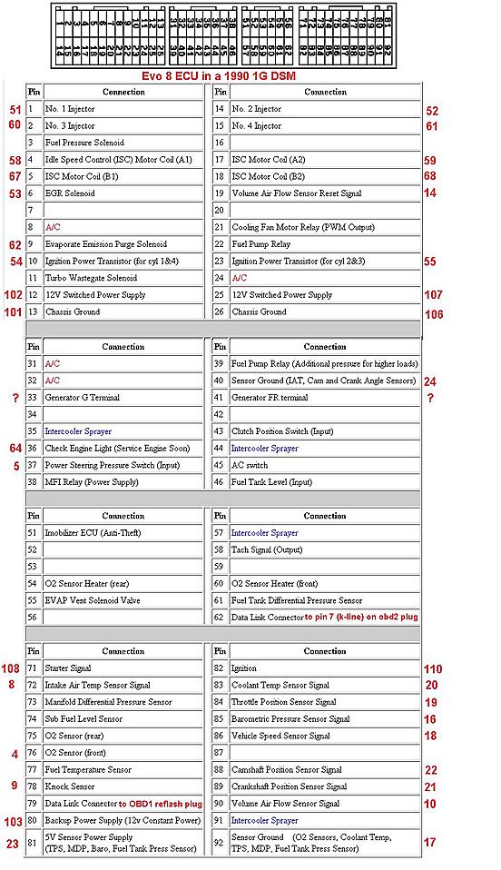

I can read/write to the ECU no problem, same with datalogging. I already know about the knock sensor issue. The car has the A/C removed already. Here is what I have connected so far:
Here is a link to the 1G DSM pinouts:
http://www.dsmlink.com/images/forums/1GECUPinout.pdf
Attached Thumbnails Evo8 ECU in a 1G DSM in the works!-evo8_1990_1gdsm_ecu_swap.jpg

- I do not have any of the ISC wires hooked up
- I do not have EGR or evap purge solenoids hooked up
- I have pin 11 on evo going to pin 105 on dsm (BCS solenoid)
- evo pins 13 I have going to dsm 106, and evo pin 26 going to dsm 101 (they are all chassis grounds)
- pin 33 does not get hooked up as a 1g alternator does not need ecu control (yours is fine)
- pin 37 I do not have hooked up as I have a manual rack
- pin 40 I have going to 17 ("clean" signal grounds)
- evo pin 41 does not need hooked up on a dsm
- I did not hook up pin 86 (VSS) as the 1G dsm is different from the 2g/evo uses a true VSS. The signal is incompatible and should not be hooked up. The VSS is in the speedo on a 1990. The VSS is mounted on the transmissoin (where the speedo cable goes into a 1g DSM).
-pin 92 evo I have going to pin 17 dsm ("dirty" grounds)
