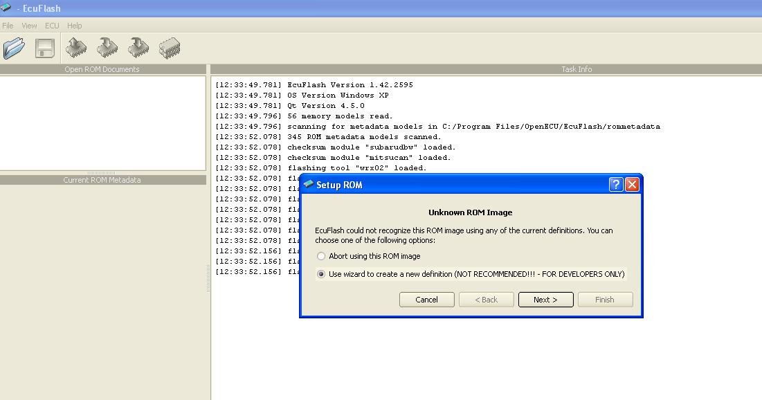

Guys
please help me with the definition file for Ecu Flash Rom meta data for
my ECU, because EcuFlash cannot recognize my ROM
My ECU ID is 8092002
It's a 2007 Evo 9 MR JDM
Already try with 8857008.xml and 8093002.xml, without any result
or maybe I missed something, coz I'm really a Newbie
this is the link to download my Hex File :
http://forums.openecu.org/viewtopic.php?f=55&t=4298
thanks a Lot

what happened when u tried 88570008? i am currently doing a rom conversion to that rom.
let me know what went wrong hopefully we can get it to work

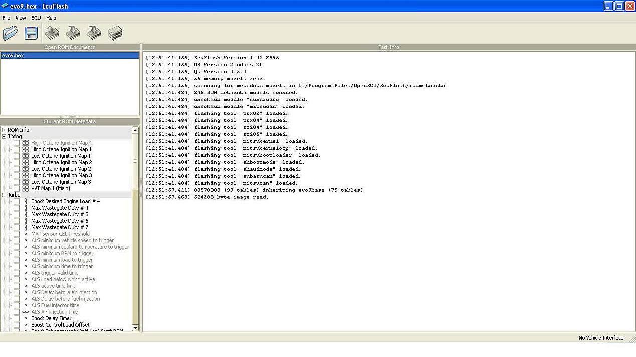

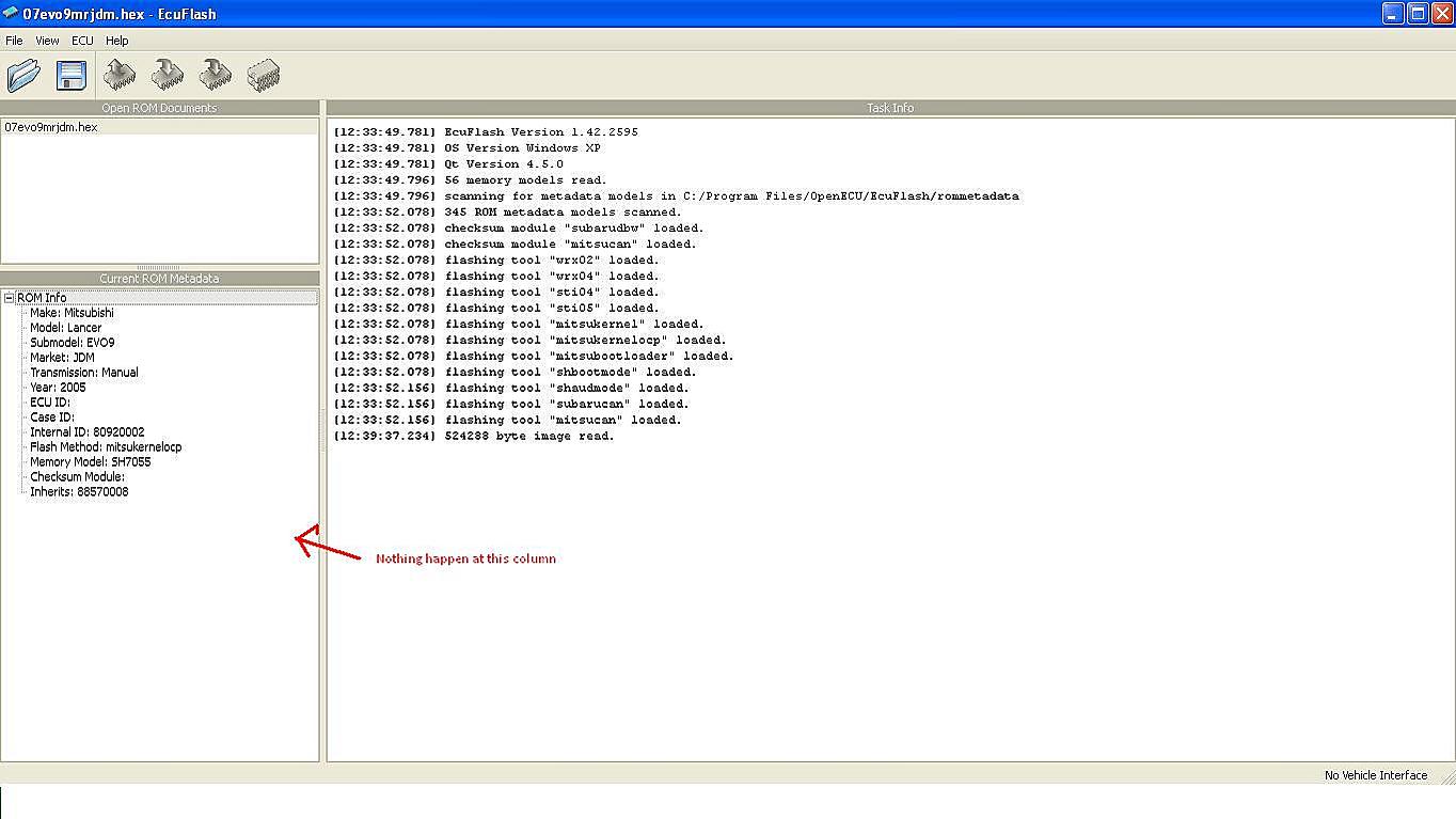

This is what happen, step by step : screen 1-4
and if i am using another hex file,from another car, my ecu flash work
like screen 5
Or You can download my hex file from link on the first post, and try to open by yourself
Attached Thumbnails HELP  Definition File (Xml) needed for Evo 9 MR JDM (80092002)-screen1.jpg   HELP  Definition File (Xml) needed for Evo 9 MR JDM (80092002)-screen2.jpg   HELP  Definition File (Xml) needed for Evo 9 MR JDM (80092002)-screen3.jpg   HELP  Definition File (Xml) needed for Evo 9 MR JDM (80092002)-screen4.jpg   HELP  Definition File (Xml) needed for Evo 9 MR JDM (80092002)-screen5.jpg

Finally , I Got the XML File from TODD, kind EvoTuner in Ireland
just save couple files which are :
- 80920002.xml
- evo9base.xml
to rommetadata folder
this is the link to copy the files:
post no3 by TODD
cheers, thanks TODD
