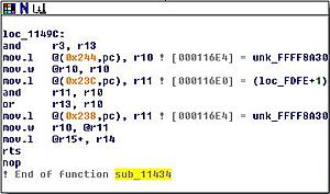

Can somebody tell me if I'm understanding the read/write method to RAM correctly?
For the second and third line of code, I beleive the processor is moving the data at ram address FFFF8A30 to register 10, this is the way I under stand it.
Line 2) The processor adds an offset (0x244 and multiples by 4 for long word) to it's current value in the PC register to locate the address of the new data. This address happens to corresponds to RAM address FFFF8A30. The address is moved into register 10.
Line 3) The data that is currently in register 10 (FFFF8A30) is used as the address to pull data from. What ever value is currently in the address that is held in register 10 is moved into register 10 to replace the address.
Contrast that with lines 7, and 8, where I beleive it is writing new data to RAM Address FFFF8A30.
Line 7) The processor adds an offset (0x238 and multiples by 4 for long word) to it's current value in the PC register to locate the address of the new data. This address happens to be RAM address FFFF8A30 again. The address is moved into register 11.
Line 8) The data that is currently in register 10 (processed data from lines 4,5,& 6) is moved to the address located in register 11 (FFFF8A30). What ever value is currently in register 10 is moved into the address that is located in register 11, there by over writing the data that was previously in FFFF8A30.

Your description sounds right to me, regarding both PC-relative and direct/indirect addressing. Just remember that "@" means indirect; instead of using the value in the location itself (ie. "r10"), you're using that as an address to look up the value you want.
The offset multipliers for PC-relative addressing tripped me up for a long time, for some reason.

They are kind of tripping me up right now actually, I've just been playing with numbers and it looks like IDA may already multiply them as needed?
If it gives a displacement of 0x80 for example, I can add 0x80 to the current line number and then I'm one long word away from where it seems like I should be reaching.

The offsets listed in the disassembled output are sort-of relative to PC. For longword-relative references, you bitwise-and PC with 0xFFFFFFFC, which might be what's been throwing you off. Also note that some displacements (12-bit disp, used in BRA and BSR) are signed, meaning you can...er...go both ways.
Finally, note that PC is always four bytes ahead of the current instruction executing; the CPU does instruction readahead, and always has at least one extra instruction in the pipeline if it can (it's why non-immediate branches execute one more instruction before actually branching). This is probably the result that you're seeing.
The software manual has a really good set of descriptions for each instruction, just in case you're using the 7052/7055 manuals to try and learn SH2 (you can almost get everything you need from there, but it's dense reading, and skips a few things).
