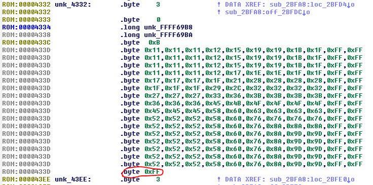

bit of a thread revival, but i would like to ask
do 2D & 3D tables have a footer byte? i noticed that while looking at the tables, they all end with an 0xFF
cheers

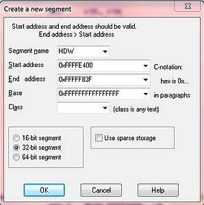

hi, hoping someone can assist me in setting up the hardware registers?
from the attached screenshot, can anyone advise what i should put in for each field?
cheers

Not seen any reference to the HDW registers in the any disassembly I've seen, but then I'm a bit rubbish at assembly. dparrish - also from Sydney did a nice expansion on Acumas's disassembly script. Seems to do good things.

i was just going off by what logic said in post 18. ill give dparrish a PM and see if can help.

Look in the hardware manual, it explains all the hardware registers.
Sorting them all out can actually help quite a bit in getting an idea of what a piece of code might be doing if it starts using hardware registers.

got a hold of the script from dparrish and that has sorted alot of things out
cheers
Nope. Any footer data that you come across is purely coincidental; the size of the table is defined up-front, and there's no finalizing byte(s).
