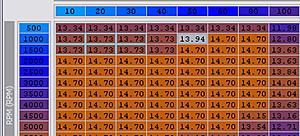

I did the tb coolant mod and had to put it back on due to cold start problems.
the only way I was able to fix my cold start was to change the lower load/rpm fuel map cells.
I still haven't been able to figure out why when temp is below 60 rpm jumps to 2100 with the clutch in and as soon as I release it the rpm goes down to 1400.
