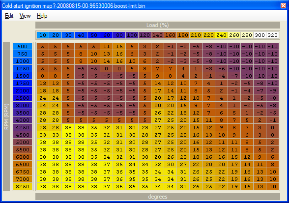

I do not understand how fuel trims that are in the good range (+/- 3%) would require a rescaling in order to allow for good cold idle / cold drivability. I say this because my trims are quite excellent and drivability when warm is outstanding.
There has to be a cold idle routine somewhere that retards timing a ton to rapidly warm up the cat. I don't think the EGR stuff does much for cold idle other than recirculating unburnt fuel to allow for better emmisions.
I recall in the 96530006 rom that there was a "timing table unknown" that had a huge timing hole in it where the car would be running if cold. Could this table be the missing link I am talking about?

No that isn't the table I am talking about.....This is it.

I found it in one of the other threads about new tables for 96530006. See post #83 above.
What is it and is this the missing link for cold drivability?
As for the other comments....I am not trying to argue. I just do not believe that we have identified the specific cold drivabilty table.
I agree completely about the EGR routines....there is something we are missing.

My ride has absolutely no start up or idle issue but that engine cold timing routine really feels wrong.... especially on a catless car.
Now I've tired the EGR bit 11 thing and that didn't fix the problem.
I need to know how to find the quoted map for editing. I'm still using ECUFlash 1.30 and it doesn't show any of these maps. What version do I need to fix the cold start timing map?

Jeff....I found it by searching around in the EcuFlash forums.....Took me a little while.
That table looks like it retards timing for rapidly warming up the cat. For those of us running no cat....it is useless....So it would be great to change it to look simular to our tuned timing maps.
This is, of course, if this map is valid and what routines call it out.
Anyone know? ? ?
