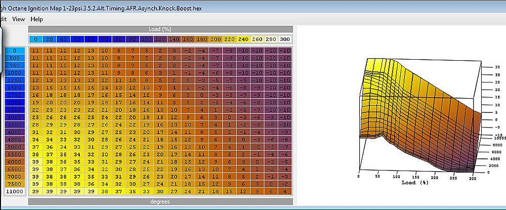

That timing graph looks quite interesting. Could I see a snapshot of the entire timing map along with the graph?

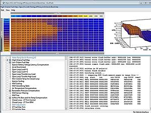

Uploaded, sorry bout the late reply.

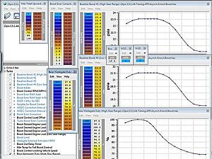

I see that, but I am talking when I first lay into boost 3-4k range, full spool, only 21 boost.
Tonight while driving freeway 180miles round trip, I am in my low boost table, as well as low timing table. I did a 3k elevation run earlier today up Big Cottonwood Canyon, and after coming back down, have found myself in the low boost area, tops out at 19...?
The timing map I did after finding knock for two months, this seems to give me only 1-2 counts approx. over 45 minutes of driving time. So I think I am in the sweetspot, I put down just a little over 300HP by converter you gave us their Jack.
Here is the full graphs, i thought for a sweet toon, make all the slopes between the boost map, fuel map, etc, they should all slope the same...?
My creative mind at work. I could really use the full help. My tuner won't answer my calls, never completed the tune, so I have been doing it on my own via reading this forum verbatum on some of the tuning...
Thanks again in advance
EDIT: Can someone explain the High gear boost & wastegate, and the Low Gear Boost & Wastegate?
I don't understand the deffinition? I know the ECU switches between these when knock is aquired. But there also is the gear based stock system that MFRED piointed out. I still have all my stock tables in play in my ROMID.xml. Could I be getting conflicting settings due to the stock deff's and the mod deff's? I know I preached about having multiple code in the ROMID.xmls causing this sort of thing before, but I feel my interpretation was way off. School me fella's, please.
It would seem that low gear would be 1st ~2nd, and high gear would be 3~5th...

Usually the timing map isn't so straight and 'linear'. This has to do with the VE of the engine and how it will allow more/less timing in a non-linear fashion. Usually, I tune the curve for 3rd gear, then gradually (in a sloping motion) have the timing go from the low load/closed loop areas down to the 'tuned' areas.
Look at this thread to see how some peoples 'smoothed out' and tuned maps appear to give you an idea. Jumperalex created an excel spreadsheet that helps 'auto-smooth' the maps out a bit for you HERE
Ok, I guess I need to read up on the closed loop areas...? Is this concidered the cruising area's? Wow, so I've been timing for smoothness, now I see how much time I have wasted trying to tune linear...lol. Do I need to start over?
Thanks again.

I think I realized what was going on today. When I started out, I was in my HIGH maps. I saw a 26psi on the dial while doing 3rd gear pull, no I didn't log it, for I wasn't thinking it could be what I am concidering. I have my Boost limit set to 26psi. SO when I saw the 26, it decided to switch to LOW map. I took a peak at my boost limit, and sur'n'uff it is set to 26 and the high 25's tapering with the baseline boost.
So question, how high above my boost curve should the boost limit be set?
Thanks in advance.
