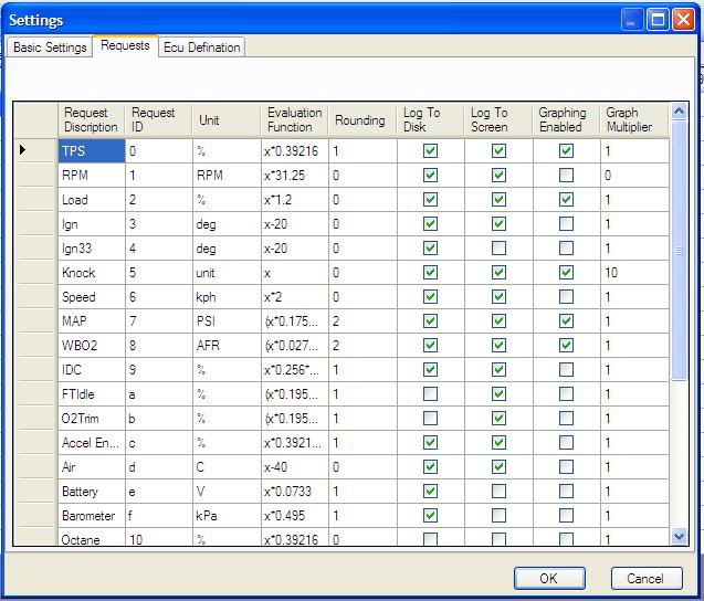

3) Check all settings to make sure they are correct, ensure that logging location and hex file name (to load ur rom tables from the hex file to ram) are correct. go through the requests table and select requests that need to be logged to disk, shown on screen and graphed. remember that the "Evaluation Function" filed can evaluate mathematical functions, but remember to add x to signify the item recieved from the current request. you can create a purely calculated field by not having x in the "eva func" if u want to include data from another request then use eg "&h01" to get the value from request 1. also the order of requests does not matter.... so its quite similar to evoscan.

This is where you setup the requests that you want to log. In my screenshot above, this is how I have my RAM MUT table setup for the time being. Simply setup your table to match what you are logging.
