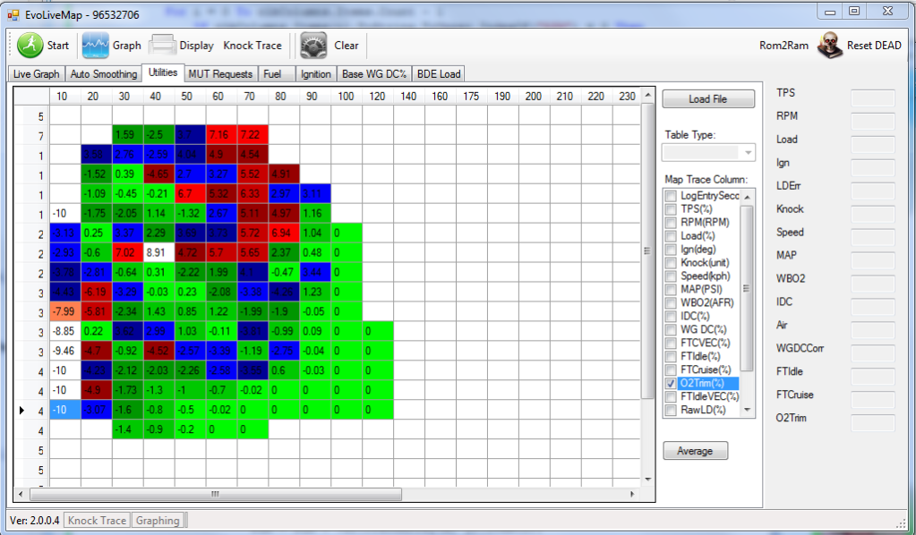

yes yes people are downloading it... but not using it... so i decide i give a sneak peak at whats next.
Old Feb 12, 2010 | 09:47 PM

Very nice...you are making good progress on this app.
