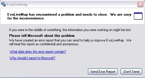

incendentally all these apps crash on my machine!
i.e microsoft send error report after pressing start

Make sure you have .net installed.

any particular 1?

best to use the latest... or atleast 3.5 sp1 i think

Start-->Help and support center--->keep your computer up-to-date with Windows update
This will auto update you.
