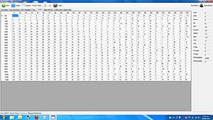

hi guys i am getting a wacky ign reading when reading my ram with live app, the fuel map loads and reads fine
any ideas, rom is 96532706 non sd, car is 04 jdm evo 8, i have transferred all my fuel/ign maps etc, live map connects etc,
any help would be great!
Phil

ign table
Phil
got it sorted! I need to press ROM 2 RAM to refresh it,
Another question, doi need to manual correct my rpm and load scaling in the live map application as it reads to 500 load but my map only goes to 320 load
Cheers Phil
ps the car seems to run better with less knock than 96260009, i havent altered any thing either, maybe smoother transition due to large scaling, maybe?
Also my coolant temp isnt reading in live map tab and timing, load, rpm not working on live graphing (but are reading on the tab beside the graph), any ideas
All read fine in evoscan, is it something to do with the mut table? if so can some one give me a hand to sort it out
