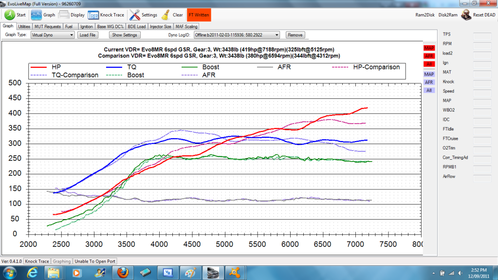

sorry no suppot for USDM evo9 roms... currently only AU evo9 rom is supported
i think i have a copy that might or might not work, from eric.. but its untested and is on a computer that is unplugged
anyway
Old Sep 12, 2011 | 05:28 AM

Looks good, ziad.
Yeah, never had anyone test the 8859 rom. Have no clue if it works or not. If you need another copy, ziad, I think I still have it on my computer somewhere.
