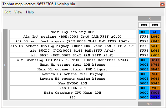

Just an FYI you need to change a few parameters in the altmap vectors to get live mapping to work (at least for 96532706). Fortunately there is a XML def for it and it is labeled well. I've attached a pic to illustrate what I am talking about.
This table just points to what maps you are using, so I have my alt-maps set to RAM were the livemap program can make changes. If left stock as when the hex file was downloaded they point to ROM so any changes made don't actually effect the car.
EDIT: These changes need to be made in ECUFLASH not livemap. so this is a general FYI as it was not obvious when it was not working for me.

yep correct...... hopefully in the next version that wont be a necessary... i am looking being able to make a normal rom into a dma rom from the program so the new rom can be flashed onto ur car via ecuflash.
obviously wont be for all roms
after that i think i will get the donation bar out like everyone else
