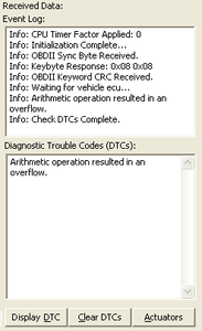

Originally Posted by evoscan
MUTII DTC is for 1997 Evo4 only.
OBDII DTC is for 1998+ Evo5/6/7/8/9
CAN DTC is for 2007+ EvoX
Oh okay. I was getting a weird math error in EvoScan when trying to pull codes with OBDII...an arithmetic overflow error or something. Had to restart EvoScan it to be able to log again or clear DTC. EvoScan, any ideas on the error?
EDIT: Tried it again and got the same result. See the attached screenshot...
